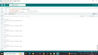

  • Dear Sir,
    We test as per your comment larger resistor value for pullup for STAT and PG pins we use 1K and CE pin to GND. But we found 2Cases and there details in below:

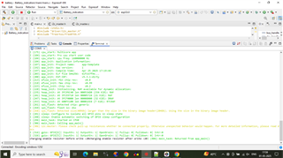

    2) we got some voltages on overall pins:   BTST-7.7V, REGN-4.9V, PG-0V, ILIM-0V, TS_BIAS-0V, TS-0V, QON-3.3V, VBAT-0.6V, VSYS-3.78V, STAT-1.6V, INT-3.78V, SDA-3.78V, SCL-3.78V, CE-3.78V, GND-0V, SW-3.78V, PMID-4.9V, VBUS-4.9V.

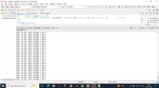

    Now we don't know is that correct value or not and also we cant connect I2C with MCU. And after connect I2C we got scanned I2C address on serial please find the attached photo.
    After we got I2C address we thought we can start for VBAT for battery Charge because we got still VBAT-0.6V.But before we write VBAT internal register on code but our VSYS voltage drop and PG LED is low and now create Case-2.
    Case 2:VSYS Voltage drop 3.78V to 0V.
    1) we think suddenly what happened and we find not only VSYS but some other pins voltage has been low. BTST-3.1V, REGN-3.6V, PG-0V, ILIM-0V, TS_BIAS-0V, TS-0V, QON-3.3V, VBAT-0V, VSYS-0V, STAT-0V to 0.150V, INT-0.002V, SDA-0.002V, SCL-0.002V, CE-0.002V, GND-0V, SW-0V, PMID-4V, VBUS-4.9V.
    Please find the yellow highlight pins voltage has been changed and now we cant read I2C address as before case 1 read.
    2) Now we tray to connect second as per case 1 but there is no change. And we connect VBAT 4V 1cell Battery and we got VSYS -3.8V. In this situation we can read I2C address and able to write charging register and show in image for your reference.
    After write charging bit we check VBAT voltage is still same 0V.
    So please guide for this problems and tell us proper way to testing this charging IC and IC part no. BQ25622RYKR. Also we test this whole things on General Purpose Board but for IC we use proper PCB board as per exact foot print.

  • Hi Margub,
    Thank you for the further detail on your test cases. Please see my comments below.
    After review of these voltage measurements the value which stands out to me is PMID = 4V while VBUS = 4.9V. PMID voltage is expected to be much closer to VBUS, similar to the 1st voltage measurements you took.
    If you remove all power sources from board then reconnect 5V VBUS do you still see a low PMID voltage?

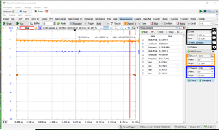

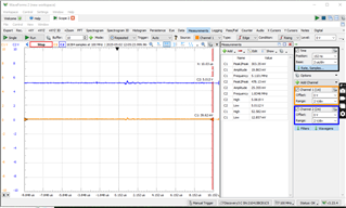

    if you are able to replicate this behaviour I recommend capturing a waveform of VBUS, SW, VSYS, VBAT which triggers on VSYS dropping in an attempt to debug exactly what is leading to issue where SYS output is no longer able to be regulated normally.

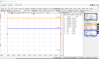

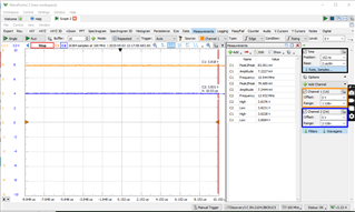

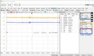

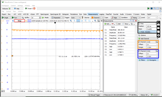

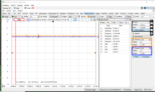

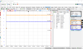

    Yes sir we capture waveform and details in below:
    1) VBUS - 5V/3A and VSYS Voltage checked in scope.CH1 is VSYS Signal and CH2 is VBUS Signal
    2) VBUS - 5V/3A and SW Voltage checked in scope.CH1 is SW Signal and CH2 is VBUS Signal
    3) VBUS - 5V/3A and VBAT Voltage checked in scope.CH1 is VBAT Signal and CH2 is VBUS Signal
    4) VBAT - 3.78V/2A and SW Voltage checked in scope.CH1 is VBAT Signal and CH2 is SW Signal
    5) VBAT - 3.78V/2A connect VSYS Voltage and SW Voltage checked in scope.CH1 is SW Signal and CH2 is VSYS Signal
    6) VBAT - 3.78V/2A and VSYS Voltage checked in scope.CH1 is VBAT Signal and CH2 is VSYS Signal
    All upper case is test on yesterday IC condition and still the same conditions.
    What do you mean by you are using a "general purpose board"?
    See we are testing on this type GP Board so is it okay and if is it okay then why we cant get proper result.
    please sir provide better solution for the same.

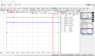

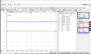

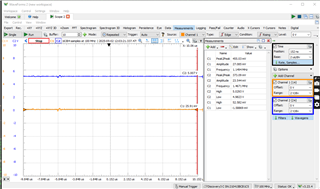

  • Dear Sir,
    we test first on yesterday IC and there waveform we have already send on previous reply. And after we test on fresh new IC and the waveform result on below:
    1) VBUS - 5V/3A and SW Voltage and CE pin is low and waveform checked in scope.CH1 is SW Signal and CH2 is VBUS Signal.
    2) VBUS - 5V/3A and VSYS Voltage and CE pin is low and waveform checked in scope.CH1 is VSYS Signal and CH2 is VBUS Signal.
    3) VBUS - 5V/3A and VBAT Voltage and CE pin is low and waveform checked in scope.CH1 is VBAT Signal and CH2 is VBUS Signal.
    4) VBUS - 5V/3A and SW Voltage and CE pin is high and waveform checked in scope.CH1 is SW Signal and CH2 is VBUS Signal.
    5) VBUS - 5V/3A and VSYS Voltage and CE pin is high and waveform checked in scope.CH1 is VSYS Signal and CH2 is VBUS Signal.
    6) VBUS - 5V/3A and VBAT Voltage and CE pin is high and waveform checked in scope.CH1 is VBAT Signal and CH2 is VBUS Signal.

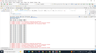

    After Checking waveform of VSYS,SW,VBAT and VBUS in CE high and low both condition we check all pins individual voltages.
     --when CE pin low overall pins voltage is BTST-8.5V, REGN-5V, PG-0.007V LED is ON, ILIM-0.0075V, TS_BIAS-0.0075-0.0086V, TS-0.0044-0.0050V, QON-4V, VBAT-2.6V, VSYS-3.78V, STAT-0-0.006V LED is ON, INT-3.78V, SDA-3.78V, SCL-3.78V, CE-0.050V, GND-0V, SW-3.78V, PMID-4.9V, VBUS-4.9V.
    In this case we connect I2C and charging register enable so we got ADC value of VBAT on serial is 2.6V and physically check on pin we got same value2.6V show in below image.
    --when CE pin High overall pins voltage is BTST-8.5V, REGN-5V, PG-0.006V LED is ON, ILIM-0.0075V, TS_BIAS-0.0075V, TS-0.0044-0.0050V, QON-4V, VBAT-2.6V, VSYS-3.78V, STAT-2.33V LED is OFF, INT-3.78V, SDA-3.78V, SCL-3.78V, CE-3.78V, GND-0V, SW-3.78V, PMID-4.9V, VBUS-4.9V.
    In this case we connect I2C and charging register enable so we don't got ADC value of VBAT on serial is 0V and physically check on pin we got 2.6V show in below image.
    Now we can see upper all case I2C read but CE pin high ADC is internally high that's why we got serial value.
    so please guide us for VBAT how we can increase and start testing for the same.0763.AE175_DT_.pdf
  • Hi Margub,
    1)Waveforms from your 1st post on old IC do appear to indicate IC was damaged. Do you have confidence the general purpose board and wires you are using can handle the expected current draw during fast charge portion? From the image the trace width on the PCB the IC is on appear quite narrow.
    2)In the waveform which includes SW expectation is SW voltage should be transitioning between 5V and 0V, similar to what is shown in Figure 9-10 in the BQ25622 datasheet. If you use a smaller time division are you able to see expected SW waveform? Given you do see SYS regulated to 3.78V it would appear buck converter is functioning.
    3)
    For this case device appears to be behaving as expected. With VBAT=2.6V device will be charging in precharge phase (default precharge current is 100mA). Are you using a real battery or a simulator in your test?
    You ask how to increase VBAT if you are using a real battery then voltage at BAT pin should naturally increase as charging is in progress. If you are using a simulator you can increase the voltage and when VBAT > 3V device will transition to fast charge and expected charge current will increase to 1.04A.
    Garrett
