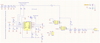

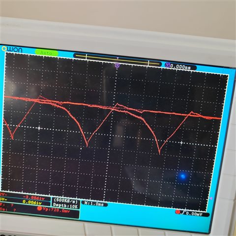

The output of my LM5122-based boost converter is stable at approximately 38 V when the only load is a power LED. However, as soon as I connect a DC motor, the output voltage ramps up and then collapses every 3–5 seconds, repeating this cycle indefinitely.
The bench power supply feeding the converter can deliver up to 10 A, which exceeds the motor’s inrush and running current.

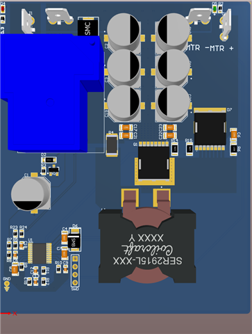

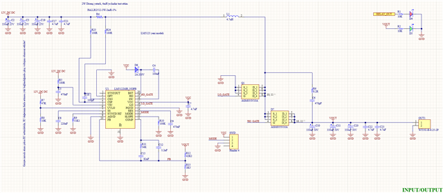

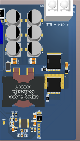

The schematic and PCB layout (attached) were copied from TI’s evaluation board, and I followed the layout guidelines as closely as possible.
What might be causing this periodic rise-and-fall behaviour under motor load, and how can I stabilise the output? Any suggestions for measurements or component changes would be appreciated.
Schmatic Image: https://ibb.co/ycnYxnRS

    I do have some general comments on the design:
    Schematic:
    - C4 is the boostrap capacitor. Is it 10uF or 100nF? 100nF would be a better selection, as this capacitor should be smaller than the VCC cap C7.
    - The compensation should be stable, but you may try another set of values to see if the behavior improves.
    For the given specs, I would recommend to replace R11 & C13 with 34kOhm and 70nF. (Based on our power stage designer calculator tool)

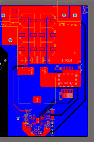

    Layout:
    - Are there any vias placed on the power ground plane near the Cin/Cout caps?
    The loop back from the low side MOSFET GND to the input/output GND is crucial for the power stage and should be kept as short as possible.

    Layout:

    I’ve just gotten access to the board and manually implemented your GND connection suggestion by drilling a hole in the PCB. With this change, the periodic speed fluctuation every few seconds disappeared, and it now runs stably at the same output voltage. However, under load the output voltage drops to 16 V, while without load, I’m seeing 37 V.

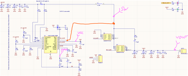

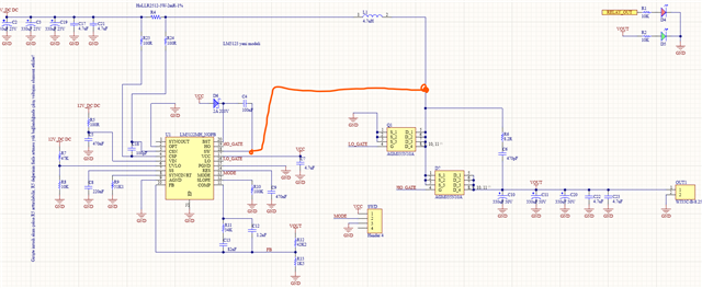

  • Hi Sinan,
    I checked the schematic once more and there is one major error I have missed so far.
    Can you please check if there is a connection between the SW pin and the switch node itself?
    Without this, the high side FET cannot turn on properly and you are operating the device as an asynchronous boost just with the body diode of the high side FET.
    This works fine at no load, but at higher load, the high side FET will break eventually.
    Maybe you can add a wire from the solder pad of C4 to the source of the high side MOSFET?
    I am very sorry I missed this in my first review.

  • Hi Niklas,
    Despite reviewing the EVK schematic and TI tool’s recommended schematics multiple times, I’d missed this critical connection. As you suggested, I bridged C4 to the MOSFET high side with a wire, but it didn’t change the result. The output voltage is around 15.5 V while the input is 12 V. Is there any specific node you’d like me to probe with the oscilloscope? To reiterate, everything appears to be fine at ~2–3 A loads.

  • Hi Niklas,
    I have uploaded the scope video.

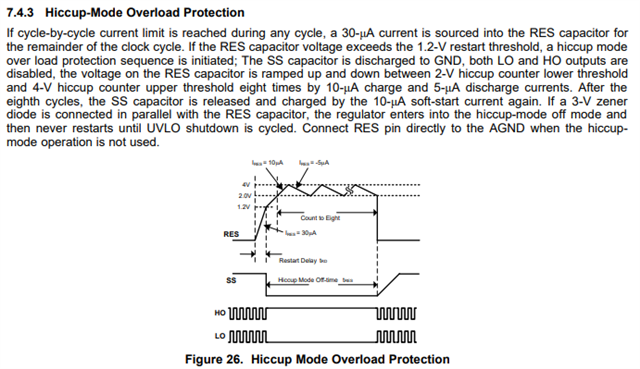

  • Hi Sinan,
    Thanks for recording the waveform behavior.
    It looks to me like the device is switching and tries to boost up the voltage, but then stops for a longer period before resetting.
    This could be related to the hiccup overload protection feature of the device.
    A description is given in the datasheet:
    If the inrush during during start-up is too high, the device will reset and the device never achieve the output voltage target.
    To verify if it really is the hiccup protection, you can replace the C9 capacitor with a 0 Ohm resistor. This will shorten the RES pin to GND and disable the hiccup feature.
    Another option is using a larger sofstart capacitor (C8). This will slow down the voltage ramp up and therefore decreases the overall inrush current.
    Niklas

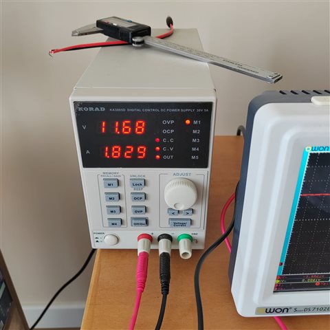

    As you suggested, I shorted the C9 capacitor to GND (I didn’t have a 0Ω resistor available, so I directly shorted it). For C8, I mounted a 1 µF capacitor. I’m sharing the oscilloscope waveform below.
    At the moment, the circuit no longer goes into a start-stop behavior, however with a 12 V input the output still rises up to a maximum of 15.5 V. My adjustable power supply is set to 12 V / 5.5 A. When I power up the system, the current is around 1.68 A, but the input voltage drops to 11.68 V.

  • Hi Sinan,
    Thanks for the update.
    Even if you disable the hiccup feature, there is still the regular cycle-by-cycle overcurrent protection, so the duty cycle gets limited if the inductor current is too high.

    What are the load conditions if you see 1.8A on the supply? Does this value make sense based on the output load, or are you operation without load on the output?

    I identified the issue as the motor’s startup current not being supported by the power supply or the 24Ah battery. After connecting the battery and the power supply in parallel, I can now achieve 37V at the output under load.
    However, the inductor and MOSFETs have started heating up. I will try to handle this without using a heatsink.

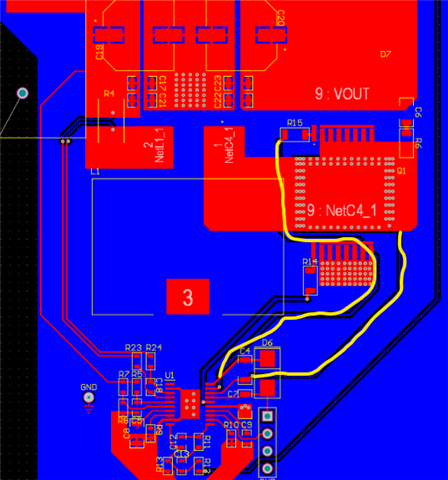

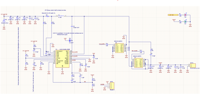

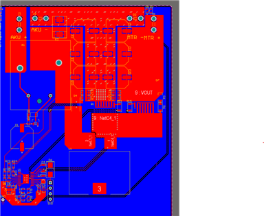

    I’m continuing on this topic thread. If it’s not suitable, I can open another one. I plan to continue here until the issues are fully resolved :)
    I’m sharing the schematic and PCB view below, could you take a look?
  • Hi Sinan,
    Thanks for the update and new files.
    I compared the schematic to the previous design and I approve all the changes that have been implemented in the revision.
    The schematic looks good to me now.
    Regarding the layout, there are still some optimizations possible:
    - The SW trace and the HO trace should be routed very close to each other. The SW trace is the return path of the high side driver current, so placing HO and SW close to each other will reduce system noise.
    I highlighted the two traces in yellow.
    - The switch node plane has a lot of vias placed. Are these vias for thermal heat dissipation, or is there another purpose?
    As the SW plane is jumping up and down, it will increase noise the larger the area of the node, especially if it is traversing multiple layers.
    - There are now vias placed to connect the LO MOSFET ground with the input/output ground, which is good.

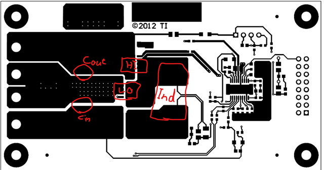

    The placement of the LO MOSFET itself is still not ideal, as the ground path is rather long. If the MOSFET could be placed above the inductor, the placement would be more ideal. However, I do not know if this is possible due to size constraints.
    EVM reference board:

  • Hi Niklas,
    Thank you for your support.
    To cool the Q1 MOSFET, I am creating a plane on the bottom layer with the same area as the Q1 pad and using vias to transfer the heat. I would prefer not to add an external heatsink. If you have any other suggestions to improve the cooling with fewer EMI issues, please share them with me.
    I have already made adjustments according to your recommendations. I cannot change the PCB dimensions, and the tall components must remain at the center.

  • Hi Sinan,
    Thanks for providing the design changes.
    The new component placement looks very good to me.
    Now, there are very short power stage loops and the trace of SW and HO are also very close to each other.
    Using vias on the SW plane for heat dissipation is okay. Managing thermal behavior and EMI often comes with a trade-off, so it is important to find a balance where both are fulfilled to an acceptable level.
    There are no further change suggestions from my side.
