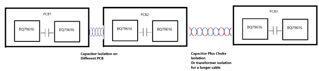

Dear Experts,
is it workable for a mixed daisy chain isolation like this?
There are two BQ79616 on each PCB using capacitor isolation, PCB1, PCB2, PCB3.
PCB2 is closer to PCB1, so a capacitor isolation cable is used.
PCB3 is far away(about 100m)  from PCB2, so a choke isolation or a transformer isolation is required.
Br.
 Alex
