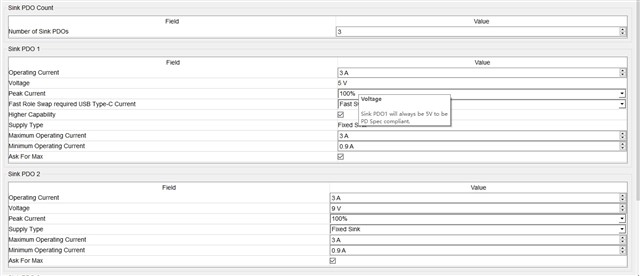

My customer use GUI TPS65981_2_6_7_8 Application Customization 6.1.4 to configure the TPS65987DDH.
When configuring SINK, Customer set the overcurrent protection point to a maximum of 3A, but the actual test found that the PD adapter protection did not shut down the PP channel.
When configuring SOURCE, customer set the external maximum output current to 0.9A, CC pull down 5.1KΩ test and found that the actual test was still us the DCDC 3A overcurrent protection, The PP channel is also not closed.
So could you help to provide some test methods or possible reasons why the OCP settings do not work, whether in source or sink mode.
    How did they test the sink? Did they just ramp an E-load? What is being used as the source?
    What do you mean here? That they expected the PTS65987 current protection to kick in around .9-A but instead, the DC-DC sourcing the power limited it at 3-A?
    Can you also share a block diagram of how they are testing so I can better understand their methods?

    Did you mean that the load should be increased step by step? I think the customer may be a jump load for an instant, would that make a difference?
    I think we will solve the source problem first.
    I just want to understand how they are testing. Please confirm their setup and provide a block diagram so I can better understand how they are testing and potentially try it on an EVM.
    Please share the pjt file they are using. This is a configuration file used with the GUI to configure the PD controller. I can't debug without this information.
    Please share more information on how they are testing. Are they using a non-pd sink? How are they drawing the current? From VBUS with and E-load?
