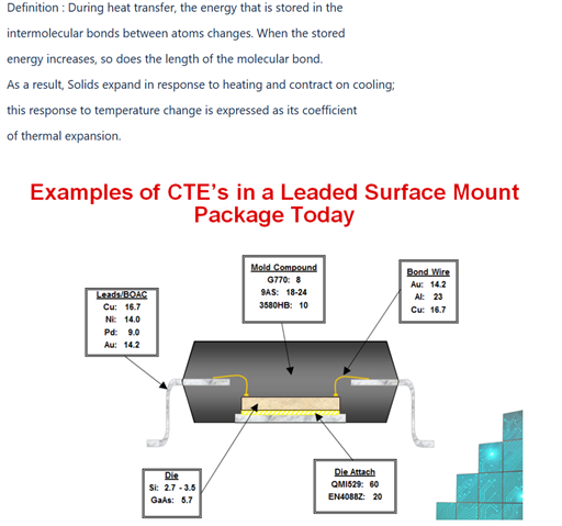

Team,
Could you please help to share the CTE((coefficient of thermal expansion)) data of this part? Thanks!
Qiang

Hi Qiang,
We don't CTE specific to this part but generic info as follows:
Gautam
