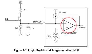

Basically the current data available in the datasheet for EN Pin is the sourcing current.
I mainly require the internal comparator leakage current ,

Hi Suman,
Thank you for reaching out. There is no leakage current into EN pin.
