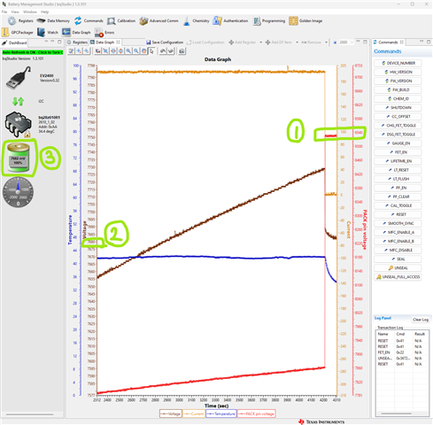

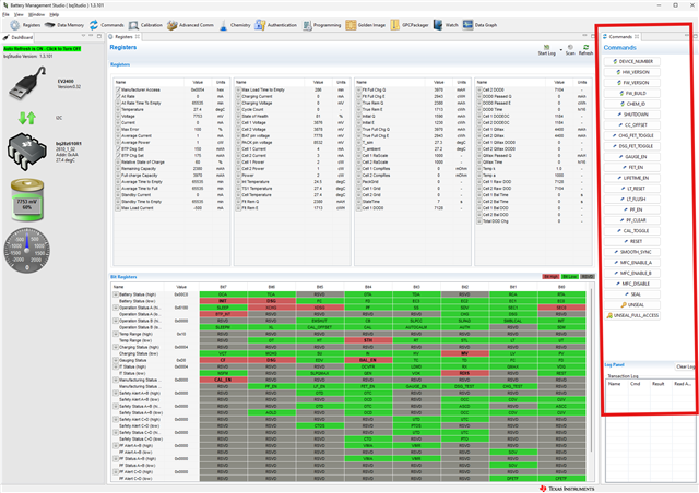

To diagnose further, I ordered the TI EV2400 programmer and used BQStudio to monitor the BMS behavior during charging and discharging. I observed the following:
  • The BMS considers the battery fully charged at voltages significantly lower than expected for Li-ion chemistry (e.g., 7.9V or 7.6V for a 2-cell configuration, instead of reaching ~8.4V).
  • I tried using different batteries but faced the same issue.
  • I downloaded the latest firmware for the BQ28Z610 from the TI website and reprogrammed the IC, but the behavior remained unchanged.
  • I have tried to turn on balancin, but it doesn't turned on.
  • I have balance the battery manule and insert them into the device and faced similar issue.
I have attached screenshots from BQStudio showing the charging data graphs and register snapshots during these events.

    Please ensure you have correctly matched your chemID using the GPCCHEM tool. Additionally please ensure you have successfully completed the learning cycle, the process for the learning cycle is outlined here.
    Jonny.

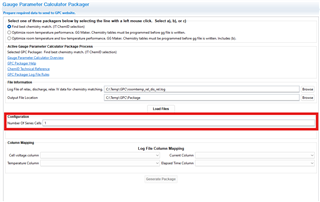

    One final point I need clarification on: I’m using a 2-series cell pack, but the TI documentation states to enter "1" for Number of Series Cell in the GPCCHEM tool. Could you please confirm whether I should input "1" or "2" in this case?
