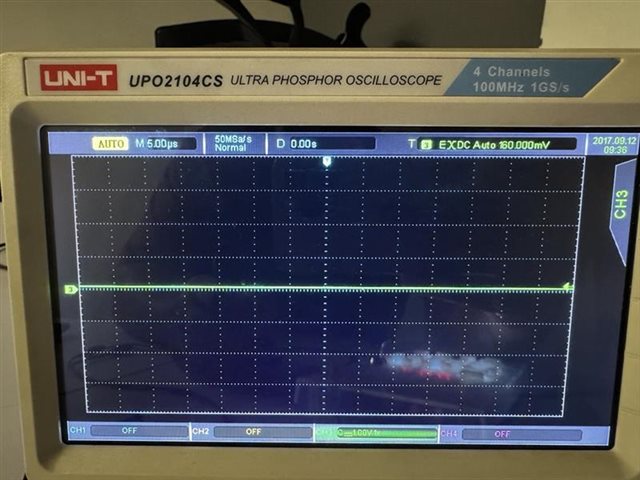

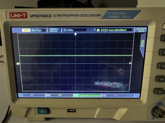

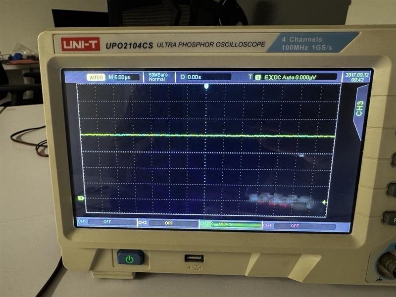

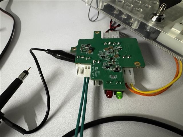

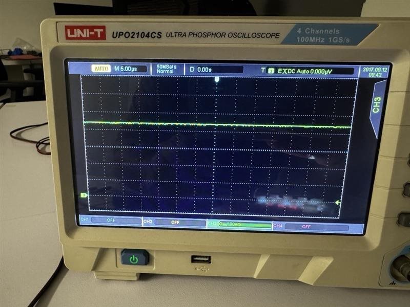

  • Hi Alec Lehman,
    Please find the attached images when the Battery is not connected to the charger:
    1. VIN
    2. VSYS
    3. VBAT
    5. Circuit when the Battery is not connected:
    When the Battery is connected to the charger:
    1. Battery Open Circuit Voltage
    2. Vin when the Battery is connected
    3. Vsys when the Battery is connected
    4. VBAT when the Battery is connected
    Please note that my oscilloscope has a 100- 200 mV offset (fault). I captured these waveforms based on the 300mA load on the VSYS. I didn't have the current probe so that I couldn't capture the current waveforms.

  • Hi Ahmed,
    Thanks for sharing these captures.
    VSYS is expected to be 4.5V when VIN is present. In your second capture, it looks like VSYS=5V.
    Could you clarify whether these captures were taken while the issue was actively occurring? Based on what you've shared, it doesn't appear that the charger was in VINDPM or DPPM, so it's possible the device entered thermal regulation.
    What is your input voltage and configured charge current? And is 300mA your typical system load?
    Alec

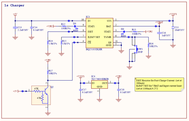

  • Hi Ahmed,
    Are you using the TS/MR pin for NTC monitoring? If not, can you confirm whether it's tied to GND through a 10k resistor?
    Alec
  • Hi Alec,
    Yes, I have tied it to GND through 10k.
    Please find the attached schematics for reference.
    Ahmed Ali

  • Hi Ahmed,
    Based on R15 = 13k in your schematic, ILIM is set to 1100mA, VBATREG is 4.2V, and VLOWV is 3.0V.
    Could you help clarify what you're seeing? It sounds like there might be two issues:
    1. The battery stopped charging for some reason, and at that point STAT2 was LOW and STAT1 was HIGH (indicating "normal charging in progress").
    2. VBAT was measured to be 4.144V when STAT1 and STAT2 went LOW. Did you mean they went HIGH? That would indicate "charge complete, charger in sleep mode, or charge disabled."
    Alec
