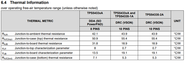

Hi there,
We selected this part as it has a good guide on use in an inverting application. Using TPS54335A to Create an Inverting Power Supply (Rev. A)
Unfortunately we are encountering thermal issues and need a higher performing part. We have created a negative 4V 3A output off a 9V supply. This device works well other than it is getting slightly too hot (double the temperature rise versus what we need). Do you have a recommendation for an alternative part that could be used at a similar price point?
