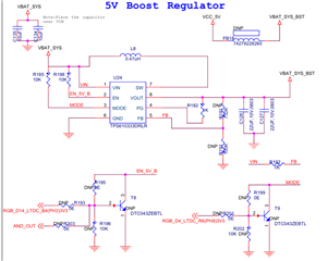

Dear Team,
Attached is the  schematic for TPS610333DRLR regulator.
We have done 2 test cases with this Boost regulator
1.With mode pull up option provided - Observed more(increase of 6mA) current in sleep mode
2.With mode pull up option removed - Observed reduced current(reduced by 6mA) in sleep mode (Mode pin is left floating)
A) Let me know whether we can keep mode pin as floating is it feasible for the design? What is your feed back on it.
B) Or is there any approach from your end to reduce the current of boost in sleep mode condition.
  • Hi Hebbar,
    For the sleep mode in your application, which of the following two conditions is correct?
    1. In sleep mode, 5V Vout is still needed, but the load is very light.
    2. In sleep mode, 5V Vout is not needed. The boost can be disable.
    Corresponding to the above two conditions, here are the comments:
    1. MODE pin can be floating, but it's more recommended to be pulled to GND.
    2. Pull down the EN to GND.
    Lei

  • Hi Hebbar,
    Thank for your information. Then pull the MODE to GND is recommended (make the MODE pin floating should also be OK), which make the device in PFM mode and the leakage will be much smaller than that in PWM mode (MODE = high), as you observed already.
    Lei

  • Hi Sudarshan:
    as there is a 1M pull down resistor at Mode pin, so when mode pin is floating ,the Mode pin is logic low (refer datasheet page 6 )
    the threshold of Mode pin is < 0.4V logic low; > 1.2V logic high; (refer datasheet page 6 )
    the minimum and maximum voltage of Mode pin is -0.3V to 7V , same with EN pin
