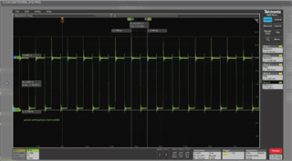

We are getting audible noise while we disconnect the battery from the charger IC(Charging Enabled) but the Load is connected in SYS pins.
If the battery is charging and Load current also consumed from SYS pin, There is no audible noise. But when we disconnect only battery without disturbing the SYS load we could hear the audible noise.
Load current is around 300mA
When charger current and Load current are consumed the switching frequency is 1.5MHz. Below waveform is from PMID pin.
When we disconnect only battery the wave form in PMID pin as in the image. (Charger IC is trying to charge battery in 9.3KHz). In this stage we are having audible noise.

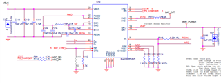

    One more observation, If we remove Inductor which is available in PMID pin, There is no audible noise.
    Below is the circuit.
    Is there any recommendation to reduce the audible noise? f

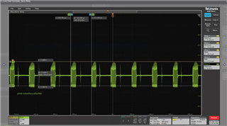

    One more recent observation.
    Based on the datasheet, Since we are not connected the battery, charger is going to PFM mode. Below is the wave form of PFM mode.
    I hope, Because of battery is not present we are getting PFM mode frequency of 9.3KHz. Please confirm.
    And Based on what criteria this PFM frequency getting fixed? Can we fix it above 20KHz, So we will not have the audible noise.
    Looking forward to your response.
  • Hi Jacob,
    As said before, this is likely caused by the charging and discharging of the output capacitor with no battery. To the charger it looks like a very small battery that it charges up, and then discharges from leakage. When you disable charge this doesn't happen. Please disable charge when no battery is present.
    You cannot remove the PMID SW inductor, the converter will not work.
    Also, we require a 47 nF BTST capacitor. We also require 44 uF close to SYS pin.
    Mike Emanuel
  • Hi Mike,
    Yes, This audible noise created from the 10uF cap which was available in the battery path.
