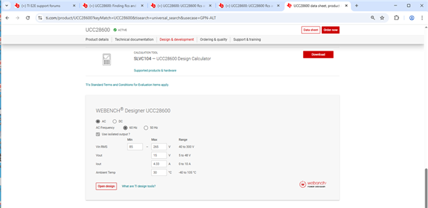

    The UCC28600 is an older device and sorry it is not clear.   If you use the excel tool and have a DC input you just need to multiply the min and max AC by (2)^0.5.
    The other option you have is the Webech design tool which can be found at the following page.
    https://www.ti.com/product/UCC28600?keyMatch=UCC28600&tisearch=universal_search&usecase=GPN-ALT
    You just enter the input and output power requirements and it will generate a BOM and schematic for you.

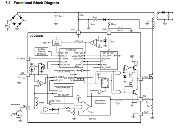

    I know what the RPL resistor is supposed to do and I am not exactly sure why they made it so cryptic in the data sheet for this device.  The RPL is just to remove offsets in peak current caused by the delay of the UCC28600 CS to output control.  The delay for this device is roughly 175 ns (td).  The offset the RPL resistor adds will cause the signal will cause the output to turnoff early to remove the error cause by td.
    You need to size your current sense resistor (Rcs) based on conventional methods using primary peak current.  The following equation can be used to size Rcs based on 80% of the power limit including the 0.4V offset inside the IC.  This is generally how I size Rcs in my designs.
    Rcs = (1.2-0.4V)*0.8/(Transformer Primary Peak Current) = Rcs = 0.64V/(Transformer primary Peak Current)
    ROVP1 and ROVP2 are used for to detect OVP and ROVP2 is used to sense the line voltage.  ROVP2 is also used to produce a current ILine that is used to generate and offset across RPL (VRPL) when the FET is on.  This is to cause the FET to run off early to remove excessive primary peak current cause by IC delay.
    ILine = VBULKmin*(Na/(Np*ROVP1)
    VRPL = (ILine/2)*RPL
    I thing the easiest way to size the RPL resistor is based on the peak input voltage (Vin_max) and change of current caused by the IC delay (di) and the transformer primary magnetizing inductance (Lpm).
    di  =  Vin_max*dt/Lpm = Vin_max*175ns/Lpm
    Rpl = (di*Rcs) /(ILine/2)
