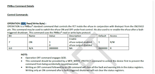

my application is planning to use Tps16890 as a switch, when power applied to VIN the switch keep in OFF state,  but TPS16890 should be enabled, telemetry will be able to response Host command.
Tps16890 ON/OFF can be controlled by PMBus.
how can I do it?
the evaluation board example shows EN pin to control ON/OFF only. when disabled, telemetry will not response to host.
