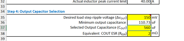

some questions about the output capacitor selection parameter:
1. What frequency does the ESR value here refer to?
2. How to calculate the ESR value when I put several different cap value of mlcc and e-cap in parallel?
3. Should the bulk e-cap put beside load side also be counted as the output capacitance here?

    What if I don't use e-caps only MLCC (Since height limitation)?
    And how "far" should I consider this into calculation, we have some loads near the boost output  and some loads relatively far away.

    "Far" means more ESL and ESR. You should calculate the impedance of the output caps (including ESR, ESL) and see which is dominating the zero. Here is an example.

    Yes the ESR of is typically very low around its resonant frequency, but it also varys by frequency. That's why I want to know the frequency of ESR in the Quickstart form.
    When you say "Far" means more ESL and ESR, you probably mean that I also need to take the ESR and ESL cause by PCB traces into account when I  calculate the impedance?

    So the ESR here on the form only affects the ESR zero and has nothing to do with the output ripple? Do I only need to concern with the ESR near the crossover frequency (for this cell)?
