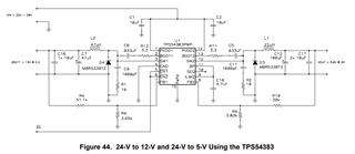

  • Hello Himanshu,
    I have a few follow-up questions and a request for design clarification:
    In Figure 44 of the TPS54383/86 datasheet, the reference design shows 5V and 12V outputs, whereas my application requires 5V @ 2A and 3.3V @ 2A from a 24V input.
    • The 5V rail from the reference design suits my needs.
    • I kindly request your help in modifying the 12V rail to output 3.3V @ 2A.
    Could you please:
    1. Confirm whether the suggested XGL4040-153MEC (15 µH) inductor is for the 5V or 3.3V output?, and recommend an inductor for the other rail.
    2. Confirm the placement of the 2 × C2012X5R0J106M (10 µF, 6.3V, X5R) capacitors — are they for input bypass or output filtering?
    3. Advise where the 150 µF bulk electrolytic capacitor should be placed — input or output? Also, is a specific ESR requirement recommended?
    4. Suggest updated component values and part numbers (inductors, capacitors, resistors, diode, etc.) for the 3.3V @ 2A output.
    5. Provide a reference schematic (if available) for a 24V input, dual-output (5V/3.3V) configuration using TPS54386PWPR.
    Dhruvil Bhadani
    • I kindly request your help in modifying the 12V rail to output 3.3V @ 2A. - All the components would work fine for 24V rail, provided you select the correct voltage rating
    • Confirm whether the suggested XGL4040-153MEC (15 µH) inductor is for the 5V or 3.3V output?, - Both
    • Confirm the placement of the 2 × C2012X5R0J106M (10 µF, 6.3V, X5R) capacitors — are they for input bypass or output filtering? - output filter
    • Advise where the 150 µF bulk electrolytic capacitor should be placed — input or output? Also, is a specific ESR requirement recommended? - after output filter
    • Suggest updated component values and part numbers (inductors, capacitors, resistors, diode, etc.) for the 3.3V @ 2A output. - can use same
    • Provide a reference schematic (if available) for a 24V input, dual-output (5V/3.3V) configuration using TPS54386PWPR

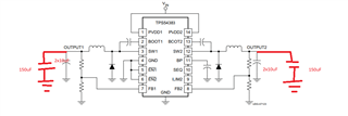

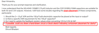

  • Dear Himanshu,
    Thank you for your prompt response and clarification.
    I now understand that the XGL4040-153MEC (15 µH) inductor and the C2012X5R0J106M capacitors are suitable for both 5V and 3.3V outputs. However, I still have some doubts regarding the exact placement of these components, particularly:
    1. Should the 2 × 10 µF X5R and the 150 µF bulk electrolytic capacitor be placed at the input or output?
    2. Is there a specific ESR requirement for the 150 µF capacitor?
    3. Do I need to update the feedback resistor values when converting 12V to 3.3V @ 2A?
    4. If possible, could you share a hand-drawn circuit or block sketch indicating component placement for clarity?
      Dhruvil Bhadani
    1. hould the 2 × 10 µF X5R and the 150 µF bulk electrolytic capacitor be placed at the input or output? - output
    2. Is there a specific ESR requirement for the 150 µF capacitor? - <50mohm
    3. Do I need to update the feedback resistor values when converting 12V to 3.3V @ 2A? - follow this equation  from sec 8.3.7 in DS
  • Dear Himanshu,
    Thank you for your continued support.
    PrayTo ensure correct layout, could you kindly share a simple hand-drawn or block diagram showing the recommended placement of the 2 × 10 µF X5R,150 µF bulk capacitor,50mohm capacitor and 15uH inductor, especially for a 3.3 V @ 2 A output from 24 V input using TPS54386PWPR?
    This would greatly help in avoiding any design errors.
    Dhruvil Bhadhani
