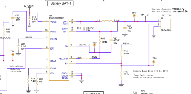

I have designed a custom Li-ion battery charger circuit using the BQ25306.
Charging Voltage=7.1V
Charging Current=0.3A
I'm encountering an issue with the BQ25306. When I connect a 6V battery to the J2 connector and power on the Vbus supply, the system functions correctly, and the battery charges as expected.
However, when I connect a 7.5V battery to the J2 connector and turn on the power supply, the REGN pin appears to short to the ground.
Could you provide any insights into what might be causing the REGN voltage to drop to zero in this scenario? Has anyone else experienced this issue?

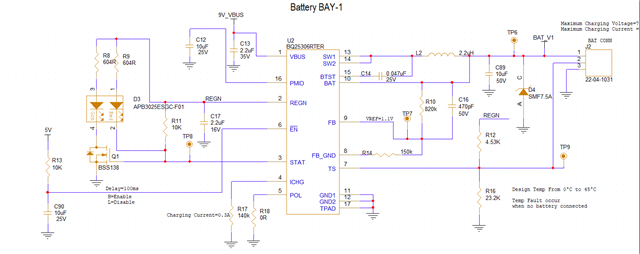

    1)Some components connected to REGN appear to be cutoff in the provided schematic. Can you please help to share a version of the schematic which shows all components connected to REGN.

  • Hello ,
    1.Please see below the full schematic of the battery charger.
    Regarding my test case, I wanted to let you know that resistors R8 and R9, diodes D3 and D4, and transistor Q1 were not assembled to the REGN pin. Additionally, diode D4 was not mounted. The STAT pin is connected to the REGN pin via a pull-up resistor R11.

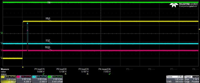

  • Hi Garrett,
    For Over Voltage condition, i have tried with new board and captured the waveform and observed REGN is shorted to gnd.
    Charging Voltage -7.1V
    Green--VBAT (7.5V)
    Yellow-VBUS (9V)
    Pink-REGN
    blue-STAT
    Sabitha N
