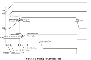

    I rechecked the architecture. V7V is indeed independent of EN states and can be high even if al ENs are pulled to GND. You can refer to Fig 7.8 in DS :
    Also, connecting ENx to V7V should be sufficient as the EN rising threshold is ~1.2V. Is the issue you are seeing is repeatable? And can you help us with your schematic?

    I'm still convinced that V7V only turns on if at least one of the EN inputs is high.
    I found the datasheet of the TPS65262 that seems to have the same architecture. And there is this behaviour explained:
    This is exactly what I have experienced with the TPS65261. And in fact that is what the Fig 7.8 shows. Voltage limit of ENx for V7V to turn on is 0.4V.
    So maybe the datasheet of the TPS65261-1 needs to be more detailed.
    Patrick
  • Hi Patrick,
    Apologies for the confusion. Looks like V7V output is not completely independent of EN pins. However, V7V output turns on as soon as VEN>0.4 as you mentioned. Hence, the device need not be enabled to get the V7V output.
    You can use EN3 to start/stop sequence, but I would recommend to use the low level for EN3 signal to be around 0.5V so the it is below EN threshold but it turns on V7V output.
