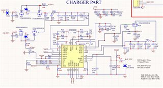

We encountered a new issue when using BQ25792, which is that some devices cannot enter charging mode normally after the battery is discharged. We set the charger voltage to 16.8V for 4s battery, and the battery voltage is about 11.4V when the battery is fully discharged.

From the register recording, there are some protection happens when the battery cannot charing. Do you have any ideas about this question?
The schematic is as below:

  • Hi Lumina,
    On the schematic, what the 10kohm resistor from SWx to GND for?  I do not recommend those.
    Does the converter stop switching completely or does only charging stop?  If the host toggles the EN_HIZ bit, does switching/charging resume?
    Jeff
  • Hi Jeff,
    This resistor is used to reduce EMI. SW is connected to GND with RC and 10k resistors.
    We captured the waveform and found that there is an output. VC2 is a Type-C charging port that can charge the battery when plugged into an adapter. VC1 is connected to a DC port and cannot charge the battery when the adapter is inserted.
    Kind Regards
  • Hi Lumina,
    The BAT and SYS OVP are not unexpected if the battery pack protector FET opens while charge is enabled.  The charger only sees the minimum recommended capacitance at BAT, charges to OVP, turns off for 30ms, restarts and repeats.  To prevent, you can add 200uF cap to BAT pin.
    Regarding VAC1 port not charging, ACDRV1 does not auto turn on unless VAC2 < UVLO voltage, i.e. applied voltage at VAC2 must be removed.  The input current limit on VAC1 is set to the lower of D+/D- negotiated value (lowest is 500mA) or ILIM_HIZ resistor clamp (set to 1.5A on the schematic.  If D+/D- are floating, the negotiated value is 3A.  What do the status and fault registers report immediately after VAC1 is applied?
    Jeff
