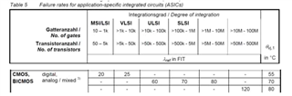

  • Based on team's feedback, TPS7A66-Q1 falls in Table5 under the VLSI row. Hopefully this helps.

  • Hey Yoshikazu-San-
    This table is included in SN29500 document.

    Thank you for your comments again.  I'm a little bit confused because your comments sound like the FIT rate of TPS7A66-Q1 is shown in SN29500 document.  I'm not familiar with the device quality, but if I understand correctly, the FIT rate of the devices depends on the device because the number of the transistors is different from the devices, so SN29500 document shows how to figure out the FIT rate of the dvices.  Therefore the FIT rate of the TPS7A66-Q1 shouldn't be shown in SN29500 document.
    I wanted to see SN29500 document, but it's not possible without paying money.  Would you please tell me the reason why the FIT rate of the TPS7A66-Q1 is shown in SN29500 document?
