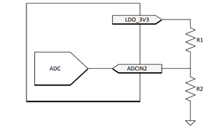

TPS65987D: ADCIN1 above DIV max
Part Number: TPS65987D
Other Parts Discussed in Thread: TIDA-050012
On the USB-C-PD-DUO-EVM specifically the TIDA-050012 board, the ADCIN1 has a voltage divider with a 10k pull-up to 3.3V and 100k pull-down, which equals to 3V.  This is above the DIV max of 1V.  What boot mode are you in if ADCIN1 is above 1V?
