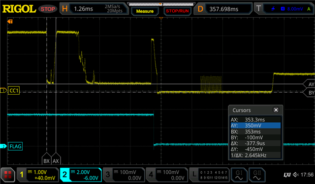

When the Device is connected on the type C connector (with no moisture ) the CC lines impedance goes low (voltage goes low approx 400mV to 300mV)
below waveform - measured on CC1 (IC input TP148)and FLAG (TP154 flag pin) in moisture fault condition.
Observation: As seen in the image above, a 350mV drift was observed on the CC line under fault conditions, and a moisture fault occurred after 4.3ms
 below waveform - measured on CC1 (IC input TP148)and FLAG (TP154 flag pin) in charging condition

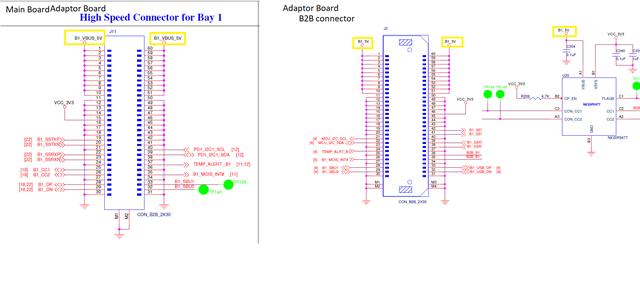

This is the Random Behaviour we are observing in our boards .Sometime the Moisture fault is generated and sometime not . Please check the waveform and schematic attached and suggest the possible solution .

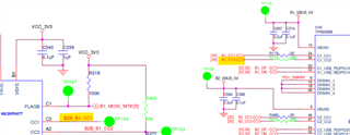

    The net names are different.  Does this mean there is additional circuitry between the nets?

     Does this mean there is additional circuitry between the nets? -- There is B2B connector between the two IC,

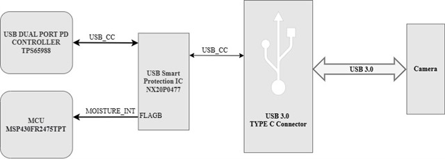

    I wanted to share the flow for moisture detection with you. Please refer to the image below for more details.
    When moisture is detected on the slave side USB connector, the NX20P0477 IC senses it, triggering an interrupt that is sent to the MCU via GPIO. The MCU then disables the switcher, which cuts off the power to the Type-C VBUS.

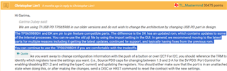

    Additionally, in the past, we used the TPS65988DHRSHR, and it worked well with the NX20P0477 IC. However, following our previous discussion with TI, they recommended switching to the TPS65988DKRSHR PD. Now, we’re encountering issues with moisture detection. We’ve reached out to you to check if any additional software configuration might be needed at PD side to resolve this issue.

    The difference between the TPS65988DK and the TPS65988DH is purely a firmware update.  The CC modem and the associated hardware peripherals are not changed.

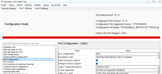

  • Hi Chris
    Please find snaps nelow from ACT tool for what we configure in our PD configurations for DK part for both of the ports.
    (0x28) Port configs.
    Port control (0x29)
    Kindly suggest what changes we should do to avoid this detection issue.

    How do these configurations compare with the DH part that worked?
    What is the intended role of the part?  Does it need to support DRP?  Can you test with SINK only or source only to see if that changes the behavior of the moisture detection device?
    Can you change the strength of the pull up resistor by decreasing the Type-C current to 1.5A or the default current.
    Chris
  • Hi
    The Intended role of the part is DFP (provides power delivery to the connected typeC device). It does not require DRP.
    We changed the strength of the pull-up to 1.5A and default current, but the moisture issue is still occurring.
    nitish

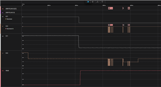

    Please let me know if there are any questions about the following waveforms:
    Order of operation:
    1. Connect port partner emulating the camera to the DUT 88DK (using project file provided).
    2. Disconnect
    3. Flip cable and reconnect (note communication is now on CC2)
    Zoom in on first connection:
    Zoom in on 2nd connection:
    Chris
  • Hello Chris,
    Thanks for sharing the Waveform ,
    So according to the Files provided by nitish , the CC pin configuration are correct in PD ?Waveform shows the  expected behaviour according to the configuration set in PD .Please help to clarify this

    Can you also comment on the difference between B1_5V and B1_VBUS_5V?  B1_5V is connected to VBUS of the protection device and PPHV of the PD controller.   I would have expected both VBUS of the PD and the protection device to be connected to the USB-C connector VBUS.

    Regarding VBUS, Basically there are two Board in DOCK
    1. Main Board
    2. Adaptor Board
    Both Board are connected with B2B connector
    PD is in main board and output of PD is B1_VBUS_5V , this net goes to B2B Connector
    But the Net name get change to B1_5V in the Adaptor Board B2B Connector NXP Protection IC is in Adaptor board  , So basically PD output supply is going to adaptor Board and NXP protection IC just net name get chnaged
    Hope this clear your doubt .
    Regarding the waveform your share ,please let me know those waveform are generated from the file which is shared by nitish ,
    Are those waveform have expected behaviour . Just wanted to know the PD setting are correct or not
    Yes. I can confirm the waveform was generated after receiving file shared by Nitish.  This waveform is expected.  You should be able to confirm the same on your side by bypassing the liquid detection device.
