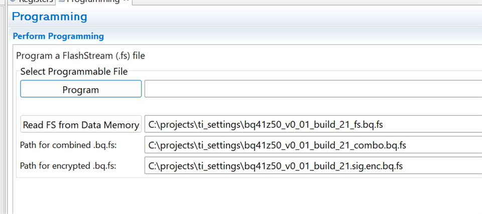

We have a battery pack that uses the BQ41Z50 that we have successfully run a learning cycle on and built a golden image from FW version 0.01 build 12.
We would like to now create a new golden image that uses the latest V0.01 build 12 FW released April 25th without having to re-run the learning cycle and redo all the settings.
I tried simply adding the new firmware to the encrypted path assuming BQ Studio would create a combined image with the existing packs FS and add it to the new firmware image.
But when I program the new combined image, the Chem ID is changed, settings etc, so it looks like we are losing all of our data.
Is there a method to upgrade the Firmware to the latest without losing all our existing work?

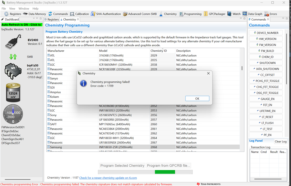

    There is an error when trying to manually update the chemID to 2068 with BQ41Z50 FW Version 0.01 build 21. "Error code = 1709. The chemistry signature does not match signature calculated by firmware"
    I am using bqStudio version 1.3.27 and the latest chemistry version 1157.
    The chem ID 2068 does work on the previous FW V0.01 Build 12.
  • Hello Trevor,
    Can you verified that you Ra table has updated? If that is the case than you programmed the chemID and the error code is most likely a mistake on our end within the system.

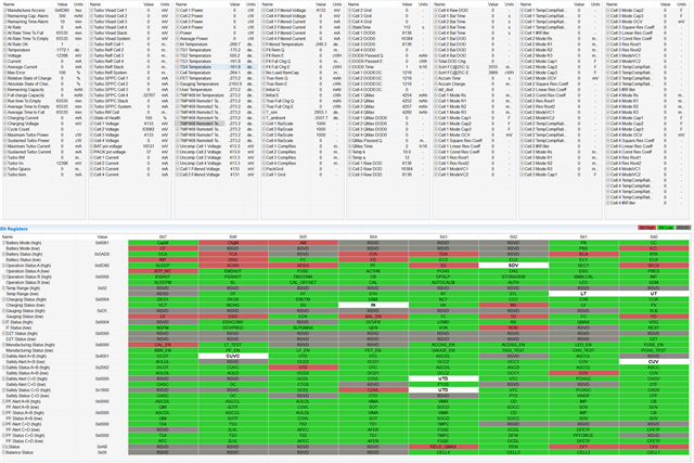

  • Hi Alan, The RA table does update after the reported failed update of the 0x2068 Chem ID. The reported chem ID after the failed update is incorrectly reporting 0xFDAC.
    A bigger issue is after flashing the new firmware then importing the .gg file from the previous build the whole app seems to break.
    Voltages are not measuring correctly (Cell 2 is reporting 63V), alarms are going off everywhere, the CAL_EN is set etc. The .gg file works properly with the previous build.
    So right now this whole process does not seem to work.
  • Hello Trevor,
    Are you importing a .gg from the same device? Also if you are seeing measurements issues is the hardware the same? If so please perform a calibration.

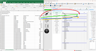

    Here is our GG file, we load this on our board after loading the new software and everything is broken.
    2021.acprs_settings.gg.csv

  • Hello Pat,
    I don't understand the confusion, you would simply open the .gg file you sent previously and cross reference the values into those said parameters, this can be done manually for assurance as well or imported into as groups but not all of them. I've attached a example of this below
    o TI does not provide a way to upgrade from one software release to another?
    TI doesn't have a tool to convert the .gg from different firmware reasons
