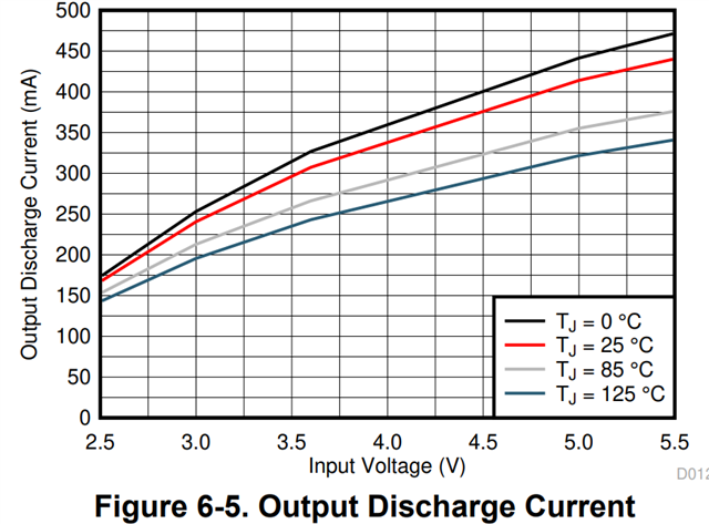

May I know how to transfer this figure to output discharge resistor?
We need compare with other product. As I know should be using outpout voltage(V)/discharge current(I)= discharge(R)
But this figure only proivde input voltage, how to I calcuate to output discharge(R)?
Thanks!
Jeff
  • Hello Jeff,
    thanks for reaching out in E2E.
    The discharge current is implemented as a current sink, which is approximately constant during discharge (see figure 8-42 in the datasheet). So the resistance of the current sink is changing during discharge to maintain the current at a more or less constant level. However the discharge current value depends on the input voltage and the temperature, which is reflected in figure 6-5.
    Andreas.
