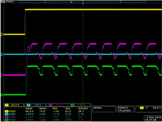

Hi Team,
LM5066I triggering a protection restart
Why is the TIMER signal not activated?
C_TIMER=10nF
CH1_Vin ; CH2_TIMER ; CH3_GATE ; CH4_FB
The current measured is very small

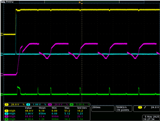

What other mechanisms will trigger protection?
CH1_Vin ; CH2_TIMER ; CH3_GATE ; CH4_Iin
