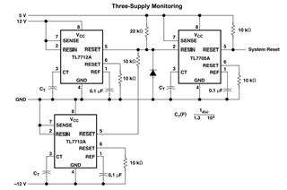

The example circuit might have a potential mistake that could damage the device.
The RESET output of the bottom TL77 is connected through a 10 kohm resistor that limits the current through the diode. The circuit in the datasheets works because when an undervoltage condition happens on -12V and the diode conducts, the voltage of the RESIN input goes to something around -0.6V to -0.8V and the absolute maximum ratings specification for this input RESIN  is -0.3 V. So, it seems to me that this circuit has the potential of damaging one of the TL77.
Can you please check the circuit and how to deal with two negative voltages at same time ?

  • Hi Tarek,
    The -.3V limit is based on a positive point of reference, so if either of the 2 top devices on the schematic detects below -.3V in the RESIN, those devices may get damage. On the other hand the bottom device has a negative point of reference which flips the sign of the limit as well.
    Also, this schematic has excited for years now and used by multiple customers. So far, there has been no significant issues reported that we are obligated to remove or configure the recommended schematic on our datasheet.
    Jesse

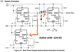

  • Hi Jesse,
    Yes, but if here is a power failure on the -12V, pin 5 will be low in reference to -12V and the diode will conduct. The voltage on pin 2 will be around -0.6V (diode VF) in respect to gnd.
    TM

  • Hi Tarek,
    We ran the simulation for the negative voltage monitoring output and it does show that the RESIN will see around -0.8V to -0.6V.
    Thanks for bringing this to our attention!
    I will be working with Jesse and the team to make any necessary changes to the datasheet.
