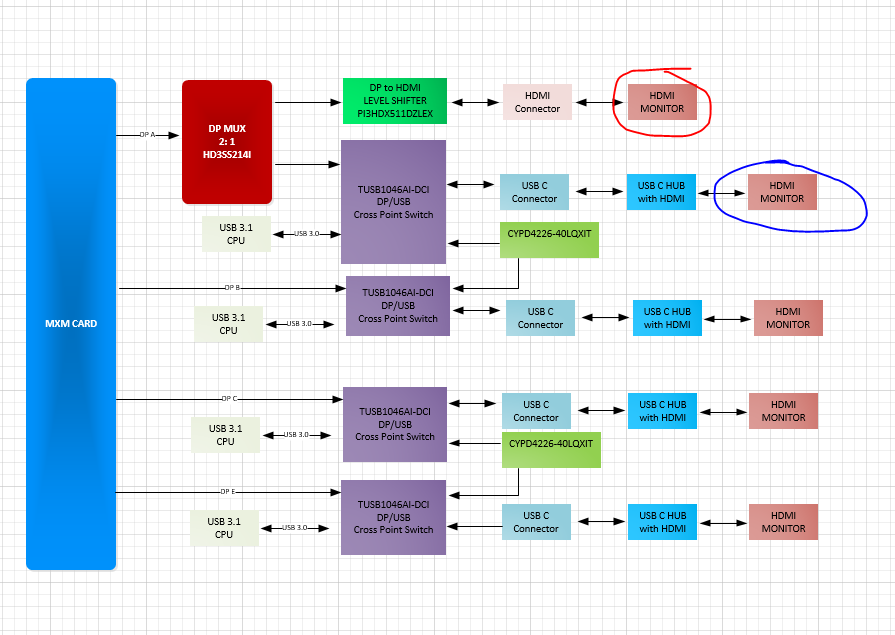

We are trying to integrate a new Xeon CPU and MXM card in our motherboard.

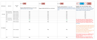

Shown below are two circles and both work well with my older MXM GPU card 1060 (Aetina M3N1060-MN-D). If we unplug-replug the monitor on the HDMI connector it works all the time. It also works if we unplug-replug the USCB C connector.
However:
When we switch it to the newer MXM card RTX 5000 (MX5000A-WAG-A1) it works well with the HDMI (red circle) but on the USB C (blue circle) it only works the very first time on power up. Plugging/re-inserting the USB C connector stops the video on the dsipaly. It doesn’t recover. We installed driver 550.144.03 (Also tried 530) on Ubuntu 24.02. On the USB HUB with HDMI (blue circle), if we remove and attach the HDMI it works. Issues seems to be with USB C.
 Any suggestions?
  • We tried two other USB C to HDMI converters. One from cable creation and another QGeekM. Both worked under all combinations reported as failed in the table below. We also tried 3 different larger Anker USB C Hub B07PPGWQ15 and these worked fine without any failures. We use Anker USB HUB B07DD8BLJW quit a bit in our projects and we tried 6 variations. All exhibit the same problem as described below. We would like to get the new GPU RTX 5000ADA work with the this USB C Hub.
    Summary of the tests:

    Next, could you monitor the CTL and FLIP pins? Assuming that you are using GPIO mode, it would be good to see what those pins are being set to to ensure these pins are being set correctly.
    Another thing you could do is perform a continuity test with the data lane paths of the TUSB1046A and just ensure that the data lanes are open in those cases where the display is not working.
    Also, just for more info, is your device in I2C or GPIO mode? A schematic may help as well.
    Ryan
  • Yes, HPDIN works as expected. The USB-C vendor looked at the logs and said they look good and it should have worked as expected.
    The device is in I2C mode controlled by Infineon (CYPRESS) CYPD4226-40LQXIT. I can send you the schematic directly. I will request friendship.
