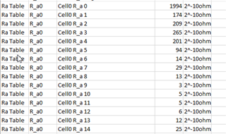

This is a 4S5P LFP pack with the capacity of 8AH. The cells has been characterized by TI, they have ChemID4207
The learning cycle was finished, the update status is 0E. But the capacity values seems bad.
Please see the config and the attached log of a full charge-up.

  • Hi Kovacs,
    Based on the .gg file, it seems like the Ra_0 point in all of the Ra Tables is significantly higher than the rest. Is it possible to run the GPCRA0 test and share the results with us so we can confirm the resistance table values?
    https://www.ti.com/tool/GPCRA0
    Anthony
  • Hi Anthony,
    Thanks for your answer!
    I seem to have forgotten that the config file does not contain the ChemID... When I was working on this pack I only loaded the config, I did not set the ChemID. Since then I have done the learning cycle resistance mapping with the correct ChemID and now the RA table values ​​are quite close to each other.
