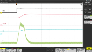

What's the current limit number during changing the Vout from 3.3 to 7V using VSEL pin?
Is the current limited number follow the Power good status?

Hi Wesley,
Sorry for late response. Current limit during Vout change is 3.6A typical. Only When the EN pin is set high, after a thermal shutdown or after the undervoltage lockout threshold is exceeded, current limit will be 1A. Below is the waveform when Vout is changing from 3.3V to 5V
