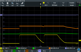

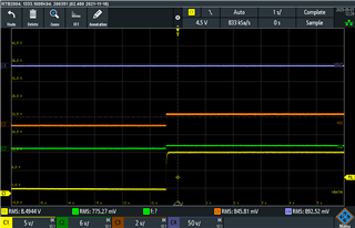

Hi team,
I am using LMR33620-Q1 in our design and in one unit it found 1.2 V is receiving on VCC pin as per the part specification it should be 5V.
could you please help me too find the reason of this failure.
input voltage is 12V
Load current is 500mA
