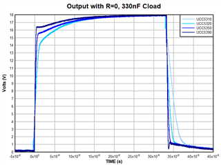

    The UCC5310 is suitable. It has the softest turn-off of this device family (below), which will likely be a benefit in this low switching frequency, high inductance application. The weak turn-off drive strength will help dampen the voltage overshoot when the low-side solenoid switch is opened. Which FET have you selected for the UCC5310 to drive? And at what switching frequency? I assume it is below 10kHz.

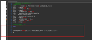

    I’m currently working on the simulation for the gate driver UCC5320SCDWVR. SPICE model available on the TI website doesn’t seem to function as expected in our setup.
    Could you please share a working PSpice or TINA-TI model for this device? It would be extremely helpful for us to move forward with the simulation.
    Thanks again for your assistance.
    Loganathan. R
  • Hi Loganathan,
    Can you please share your simulation file? I will try to see what the issue is.
    Sean
