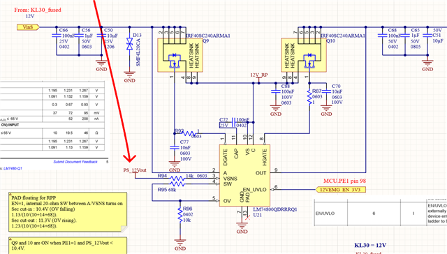

LM74800EVM-CD: LM74800QDRRRQ1 circuit operation
Part Number: LM74800EVM-CD
I have set the LM74800 controller to enable when PS_12Vout ~ 10.5V.
I am seeing Q10 source voltage oscillating between 8-10.5V when U21 enabled even under 10-20A load.
Is this expected? Shouldnt Q10 be fully enabled during moderate loading condition?
