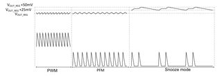

    May I ask two additional questions?
    1. What is the difference between DCM (Discontinuous Conduction Mode) and Burst Mode?
    2. Could you please explain the conditions under which the device switches between Normal Mode and Burst Mode?
  • Hi Yasuto,
    You could refer to this figure to distinguish between  DCM( the same with PFM mode ), burst mode and normal continous switching mode.
    For detailed description, you could refer to TPS61299 data sheet section 7.3.1, which is much more readible and easy to understand.
