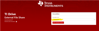

  • Hi Felix,
    theanks for your message/ mail. So I test & try to log in. but I haven't luck.
    So I try with my TI account (mail adress) but the sstem don't accept the Log-In date. It's maybe a question, I need a additional account (TI Enterprise or ENT.TI.com)?
    I have received your information about the attachments, which zip file must be selected, and Powerpoint.
    Can you help me.
    Best regards
    Alexander
  • Hi Alexander,
    I'm also not sure why....
    I attached the zip file here directly. Please let me know when you complete the download.
    LP5860EVM Sample Code C-Language.zip
    Felix
