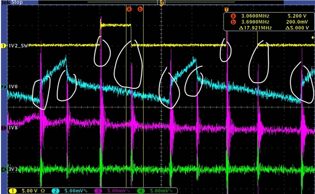

we are facing noise pickup on a new prototype board featuring several TI step-down switchers.
We must generate several voltages in the 1V0 ... 3V3 range that "gather" underneath an FPGA (core voltage, aux voltage, several I/O bank voltages).
The board features 3 TPSM82864 and 2 TPS82130. All are using the same 5V VIN. The TPSMs are running in forced PWM mode (with external FB divider).
We (seem to) have evaluated that much, that the (internal) switching of the TPSMs is "generating" the noise that is seen on the TPS82130 output voltages. The TPSM output voltages seem to be fine (just normal ripple in the range 10mVpp, no pickup noise here).
The TPS82130 output voltage (5V VIN, 1.8V VOUT) shows the expected ripple (in frequency and p-p voltage), overlayed by 120mVpp pickup noise "peaks" (noise is rather wide in spectrum, around 500MHz). We have "pinned" the noise peaks to the switching moments of the 3 (free running) TPSMs (scope shot). Looking at the TPSM SW pin, this one is generating really fast switching edges.
The noise is already present at the TPS82130 VIN (5V), so it may be that the noise that has initially been detected at the TPS82130 output (we are having micro-coax connectors on our onboard output voltages that connect via 50R + u-coax/SMA-50R-cable to the BNC connector on the scope 1Meg input) is just passed through by the TPS82130 (and so becomes visible at its output). The noise is not present (or at least not measured that high) in the area were the 5V source enters the board). So it seems the 5V = VIN noise is generated on board at the times the TPSMs are switching.
Layer stack is L1 (Top), L2 (GND), L3 (Signal), L4 (Signal), L5 (GND), L6 (Split Power 5V0 = VIN, 1V0, 1V2, 2V5), L7 (Split Power 1V8, 3V3), L8 (GND), L9 (Signal), L10 (Signal), L11 (GND), L12 (Bottom).
TPSMs: CIN 22uF, COUT 2x 22uF. TPS82130: CIN 22uF, COUT 22uF.
Any ideas were to look at? We seem to know who is "initiating" the noise, but what happens exactly? What can be improved in the layout? Should we have added some 1..10nF caps to the TPSM or TPS inputs? Can anything be done at the SW pin (snubber etc.)?
  • In the scope shot above, the 3V3 TPSM has been disabled. The remaining (active) TPSMs are for 1V2 and 1V0. 1V8 is the TPS82130 that picks up the noise. 1V0 shows the corresponding TPSM output, 1V2_SW shows the SW node of the 1V2 TPSM (it had not been that clear from the output waveform when this TPSM really switches). The cursor window shows nothing in particular.

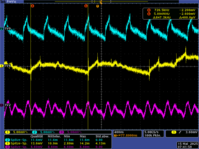

    Thanks for sharing the waveform.
    How does the ripple/noise look when no other scope channels are connected to anything?  Noise, from SW, can couple between the channels in the scope.
    In many systems, where multiple power converters share the same input voltage, ferrite beads are commonly used on the input of each switcher so that the noise from one of them does not appear on the shared input bus.
    Noise may also be coupling from the input to the output, through the PCB layout.
    Can you share the layout?  We can check for such a coupling path and if there is a suitable place to add a ferrite bead.
    Chris
  • Hi Chris,
    Noise stays the same with only one scope channel active and connected.
    Yes, we should have added some ferrite beads at the inputs. I think we did not care that much since there is no "analog" function on this one (no ADCs, DACs). However this was rather unexpected (the TPSM is a new part for us) and concern now is for PLLs and overall EMI.

    Is the other TPS82130 (the one closer/adjacent to the TPSM82866) showing any noise/issues?  The TPSM82866's Vout plane is directly adjacent to the Vin plane to that TPS82130.
    Yes, the common 5Vin plane is adjacent to 2 of the output planes on layer 6.  So, noise could be coupling there.
    Is it possible to run this test?  Cut the Vin plane to the troubled TPS82130, between the cap and the vias.  Then, supply 5V to the cap from an independent lab power supply.  Is the noise still there on the output?
    You could also try powering that cap from the 5V on the board, through a ferrite bead to remove the board's noise from that rail.

    As suggested, we have cut the 1V8 TPS82130 VIN pins & CIN pads from the (two) VCC plane vias on that top-sub-plane, and have connected a dedicated 5V DC source directly to CIN.
    We get the following results (the TPS82130 is in PSM mode all the time here):
    Case (1) 1V8 VIN & EN ON (from dedicated 5V source) and main VCC (TPSM 1V0 VIN & 1V2 VIN) OFF
    >>> We see no level or noise on 1V0 VOUT (as expected), we see typical ripple on 1V8 VOUT (appr. 20mVpp) and some switching noise on 1V8 VIN (that does not come from the R&S lab DC source but seems to correspond with the 1V8 TPS82130's own switching).
    Case (2) 1V8 VIN & EN ON (from dedicated 5V source) and main VCC (TPSM 1V0 VIN & 1V2 VIN) ON
    >>> We see typical ripple on 1V0 VOUT, we see the high switching noise on 1V8 VOUT and (as it seems, only) the TPS82130's own switching noise (low freq) on 1V8 VIN. We definitely see switching noise peaks on 1V8 VOUT while the 1V8 VIN shows none (is very quiet).
    Case (3) 1V8 VIN & EN OFF (from dedicated 5V source) and main VCC (TPSM 1V0 VIN & 1V2 VIN) ON >>>
    We see typical ripple on 1V0 VOUT, we see no level or noise on 1V8 VIN, we see the high switching noise on 1V8 VOUT.
    So it seems that the TPSM V_IN/I_IN noise (board VCC 5V) couples to the 1V8 VOUT (not to the 1V8 VIN).
    Not sure if this would be because of a high delta current (on main VCC) or because of a rapid 5V delta voltage on the SW pad.
    Maybe we have a coupling between L6 (relativly narrow Vcc channel) & L7 (1V8) overlap region as shown in the picture? But that would only "explain" a coupling between 1V2_I_IN and 1V8 VOUT, not between 1V0_I_IN (the 1V0 TPSM is located on the right side of the 1V8 TPS82130 and the main VCC enters from the right side of the PCB)?
