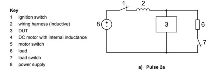

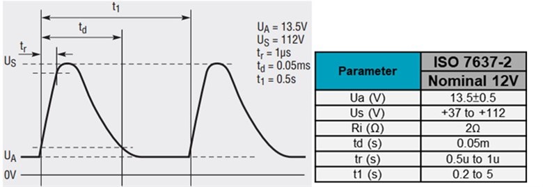

My customer would like to use LMR66430R5RXBR(operating freq at 2MHz) to pass the ISO7637-2-Pulse 2a test.
They will add a 58V EMI/EMC protection component at pin-out Vin of LMR66430R5RXBR, and do the many times test to apply a 58V voltage with 50usec at Vin, is the LMR66430R5RXBR pass this test? if there have any suggest device, please advise it.
They also would like to know the pin-out Vin of LMR66430R5RXBR in transient status, it can support the voltage range is?(ex:100V), the time range is?(ex: 1msec)
