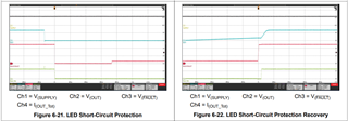

    The TPS92629-Q1 has integrated short-to-ground fault detection in which the current is disabled if the output channel is shorted to ground. Please refer to section 7.3.6.1 in the datasheet for more information.
    Figures 6-21 and 6-22 show measured results of LED short-protection and auto-recovery features.

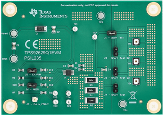

    The short-to-ground test result provided in the datasheet should be close enough to the standard. We can always sample a TPS92629Q1EVM for the customer to verify the short-to-ground fault protection. We have jumpers populated on the EVM specifically for this type of short test.
    https://www.ti.com/tool/TPS92629Q1EVM

    There is no limit to the number of times the output can be shorted to ground. The device is a constant current source, and is capable of sourcing a constant current into any load including directly ground. The internal short-to-ground detection is typically used as a diagnostic tool, and to protect other system elements during a short-circuit event.
    You may refer to the FAULT table (section 7.3.8 of the datasheet) for more information on fault handling.
