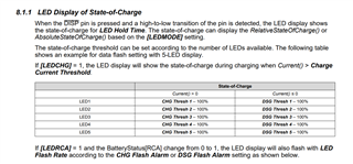

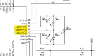

We are currently looking for a replacement for the BQ20Z655 IC. A critical requirement is that the IC must be capable of directly driving a 5-segment LCD display.
Based on our research in various forums, the BQ40Z50 is frequently suggested as an alternative to the BQ20Z655. However, from what we can tell, it does not appear to support direct driving of a 5-bar LCD display.
We would greatly appreciate your guidance and support on this matter.
  • Hello Hasan,
    It depends on the LCD, but you are able to drive 5 leds with the battery gauge.
    Thank you,
    Alan
