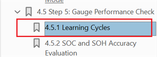

  • Hi Kartha,
    Here is the latest MSPM0 Gauge code, Gauge GUI and document. We add more fantastic algorithm in it. Besides, we also include the BQ76905 in the MCU code as well.
    Gauge Level2.zip
    For your two questions:
    1. In the latest code, we add a function to enable MSPM0 to save the gauge data and recall it after reset. You can enable the data saving function when the battery voltage or MCU voltage drop under a certain threshold.
    2. When connecting the battery for the first time, the algorithm will compenstate for the SOC error when it starts to work. For more details, please refer to the chapter in the doc in the zip file.
