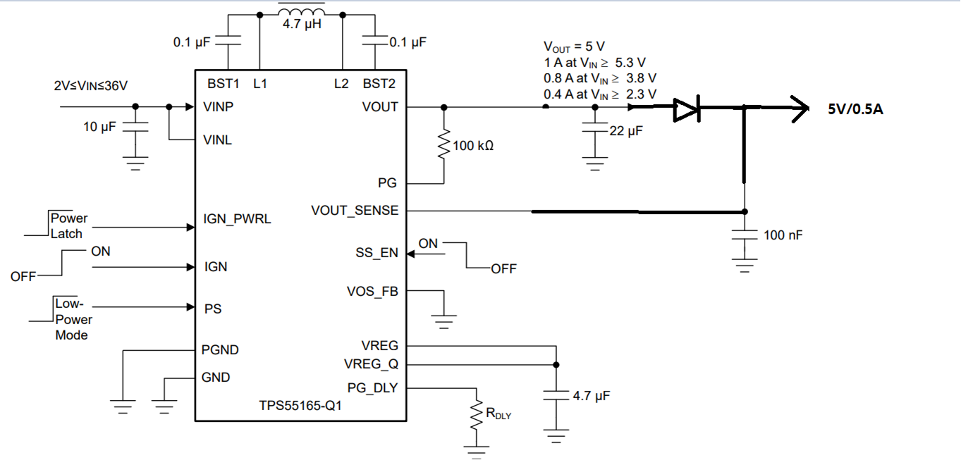

TPS55165-Q1: Is it okay to add a diode in sense feedback?
Part Number: TPS55165-Q1
Dear TI experts,
Could you confirm that it is okay to add a dilde like a schematic below?
My customer should use diode in the output of TPS55165 because of end customer's request.
But as you know If I add a diode normally to the output of TPS55165, final output is about 4.7V because of a diode.
So my customer modified a schematic like below and finally it is working, output is 5V. But I want to confirm this is okay or not.
Chase
