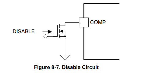

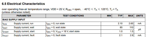

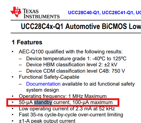

Regarding the datasheet of UCC28C41-Q1, it shows the current is 50uA, 100uA(max) in standby mode. However, we don't find any introductions about how to enter standby mode.
Before, we used disable circuit to let UCC28C41-Q1 shutdown as shown in Figure 8-7, but can't reach very low power mode.
Do you have some materials or comments to introduce how to enter standby mode?
