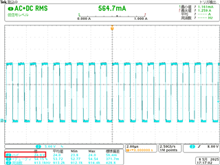

When Vin sets 24.0V and Io=1A, there is no jitter on switching node as below.(OK)

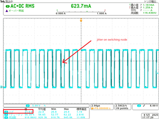

When Vin sets 21.6V and Io=1A, there is jitter on switching node as below. (NG)

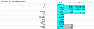

The schematic we use is follow and if we use Rt=124kohm, jitter on switching node makes worse.
