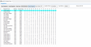

    The register values when charging stops are as shown in the figure below.
    Duan.

  • Hi Tiger,
    The register values as below.It seems like that there is no fault triggered.And as I said before,I used a 2 mR sense resistor in my design.Could this issue be causing an incorrect configuration of the input current limit value?Could you please review my register configurations to check for any potential issues?How should the register values of current be converted to actual measurements under these conditions?Besides,I don't have TI EVM of BQ25723.
    Duan
  • Hi, Duan,
    BQ25723 does not support 2mohm current sense. My suggestion is to follow TI BQ25723EVM user guide when starting your battery charger design.
    User guide BQ25720, BQ25723 Evaluation Module
    Tiger
