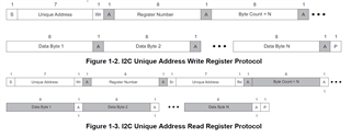

    As far as writing to register 0x28, even writing the same data back to the device it seems to become corrupted, even though it looks OK to me over the logic analyzer.
    Sending "smbus_readblock 0x20 0x28 17" over a terminal yields the following data: 00282E0100000000000000000000000003
    Note the datasheet suggests the register is only 16 bytes but the device responds that there's 17 bytes, maybe it's a firmware change to TPS25751.

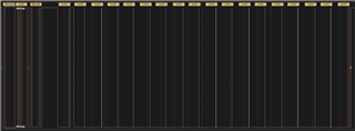

    Reading 17 bytes from register 0x28 as seen by my logic analyzer. Matches the terminal.
    Then if I write the same 17 bytes back....
    smbus_writeblock 0x20 0x28 17 00282E0100000000000000000000000003
    I get sensical data on the logic analyzer that matches expectations.
    From the TPS25751 EVM (Note, TPS25751 responses shown in Grey)
    Then when I read the data back, it responds that there's no LENGTH to register 0x28.
    Looking at my USB-C inline meter (Current / Voltage display), it's apparent that trying to write to register 0x28 is resetting the chip. It's back in PTCH mode.
    I have verified that the TPS25751 device after reset (before PTCH->APP) responds to a read of register 0x28 the same way.
    If I read 16 bytes on register 0x28 and write back the same 16 bytes on register 0x28, the same reset/crash behavior occurs.
    It appears that the second byte being read/written, 0x28, is invalid.  I will try to reproduce on my side.
