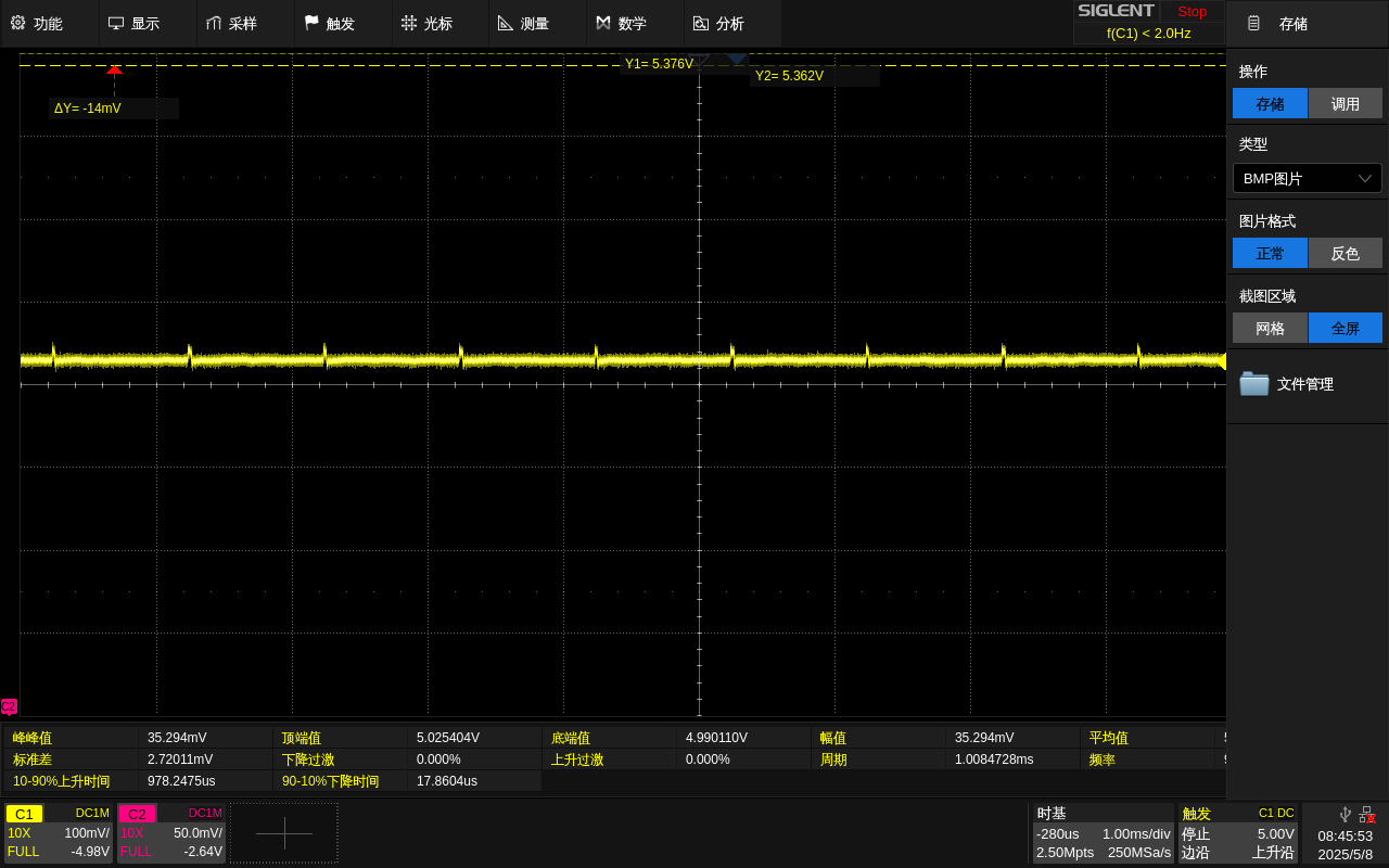

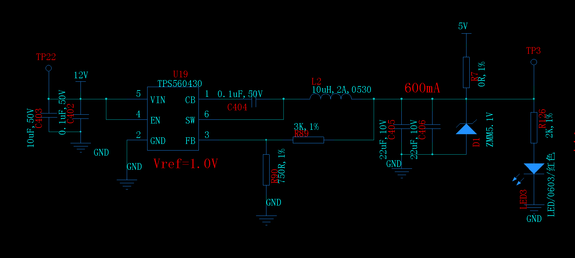

HI,erery one,I have a issue about of the IC that is TPS560430XF(1.1MHz,PFM),below is light load,the out have a period output fluctuation,about 1ms,below is the out:

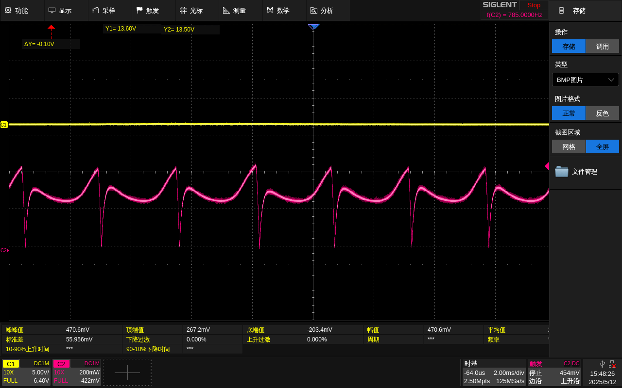

1.when access load,the output fluctuation is large than light load.
I have L is 10uH/2A,Vin=24V,Vout=5.5V.
