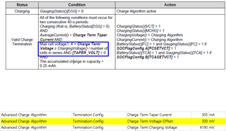

I have a question about the charge termination condition in the technical report of BQ40Z50.
If you look at the content, it is stated as
Max Cell Volrtage + Charge Term Voltage ≥ ChargingVoltage() /
Number of cells in series.
The value of ChargingVoltage() should be a multiple of 2 times the Number of cells in series for 2S configuration. However, I cannot find the corresponding item in the TI Battery Management program.
Is it Advanced Charging Algorithm --> Termination Config --> Charge Term Charging Voltage? I set the value to 4190mV, which is the charge termination voltage of 1 cell, and the correct charge termination occurred.
