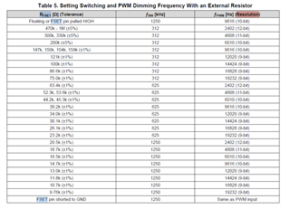

My customer wants to set a frequency of around 400k, but there is no corresponding resistance value. Could you please give the specific frequencies corresponding to 56kΩ and 68kΩ resistors? Thank you!

Hi Eileen,
Please follow table5 for the frequency and resistor selection. The frequency setting is not continuous but discrete.
