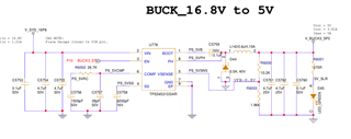

Kindly review the design of the TPS54531DDAR buck regulator and confirm its correctness. A block diagram is attached for your reference
Hi Binahah,
Output caps seem very small. Recommended 2nos 47uF.
