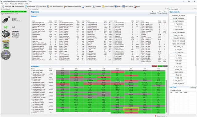

  • Hi,After this battery pack was left idle for a period of time, it was found that there was a DFW setting. According to the specification sheet, it says' Data flash write not successful '. Why did this cause this, and I cannot use the PF_CEAR command to clear the PF flag anymore
  • Hello Ian,
    The gauge's data flash wore out from being flashed to many times or was damage from an ESD event. Once this happens, the gauge will permanently disable the pack. There is no recovery and it is recommend to do rework on the pcb and replace the IC.
    Thank you,
    Alan
  • Hi,ESD causes flash abnormalities in the battery meter, whether it is caused by ESD coming in from the I2C interface, B+, or P+. Specifically, what network ESD is causing flash damage
  • Hi Ian,
    The DFW flag only specifies that the Data Flash write was not successful from the physical level. The device is not able to decipher which pin an ESD event has affected. Are there any exposed connections in this system that could give us an idea how this occurred?
    Anthony
