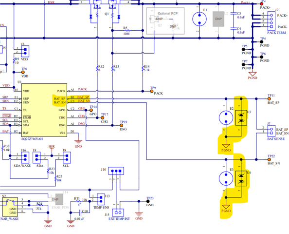

Is that necessary to add 100ohm resistor in BAT_SP, BAT_SN pin to enhance ESD protection ability? Is that any side effect. Had place 5V TVS here.

There is no 100ohm resistor in BAT_SP, BAT_SN in the EVM but regardless having a 5V TVS is recommended to use based on the EVM.
