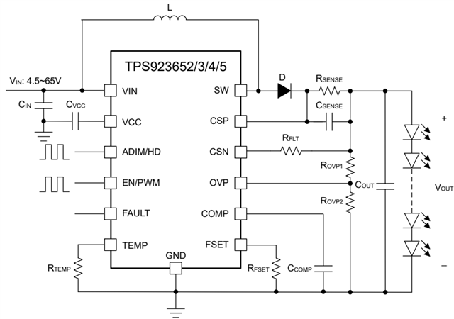

At short notice, our customer has requested that our product support multiple display types, each with a different backlight configuration.
As a result, I need to quickly find a backlight driver that can support various LED backlight types.
Goal:
We want to configure the driver for different backlights by swapping only the feedback resistors.
Input Voltage Range:
20.4V to 28.8V
Backlight Requirements:
  • 3.2V @ 60mA
  • 6V @ 240mA
  • 21V to 27.5V @ 40mA
I have selected the TPS923652.
Questions:
  • Do you think the TPS923652 is suitable for this use case?
  • My calculations show different inductor values are needet for each backlight. Can I use the maximum required inductance for all configurations, or do I need to reduce it depending on the display?
